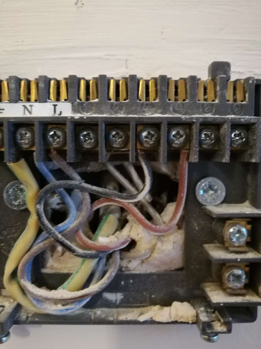

veeg33 Posted November 24, 2018 Posted November 24, 2018 Any heating engineer here in the forum that happy to give some advice? Purchased a Nest 3rd gen learning thermostat. I'm good with most DIY at home but this is a bit tricky as I'm not too sure where things are. My hot water tank has a junction box, Danfoss Wb12, I have a Danfoss programmer Tp9000ma-si and Worcester Greenstar Ri boiler. Junction box is next to the water tank upstairs, programmer is downstairs next to the stairs and boiler is in the garage. I've seen many examples of people replacing the programmer with the Heat Link and have the Nest thermostat plugged into a USB power somewhere else. But i wanted to replace the programmer with the Nest thermostat and have the heat link hidden somewhere (assuming I can wire it next to the junction box in the airing cupboard?) I have removed to cover on the programmer and took pic of the wiring (1st pic below) . Then i went upstairs to remove the junction box cover and took another picture and try if I can match the cables. (pic 2). It has 12 points, however the white cable that goes into the junction box doesn't seems to match the cables that goes into the programmer hence I'm stuck. Is my thought process correct? Quote
veeg33 Posted November 25, 2018 Author Posted November 25, 2018 After an hour tracking the existing wiring, I've managed to install this and now fully working Quote

veeg33 Posted November 26, 2018 Author Posted November 26, 2018 38 minutes ago, Paul K said: Good job...i had to mess around with mine to get it to all work properly....now its all active and has been for a year..... It's pretty easy once I've tracked the cables going into the original programmer. Got a quote this morning from a 'Pro Installer' near me, £99.00 including VAT.......That's extra £99 in the pot for mods on my zed 1 Quote
