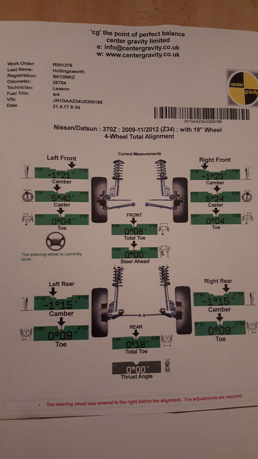

nissanman312 Posted December 5, 2017 Posted December 5, 2017 (edited) Here's what centre gravity did with mine it drives a treat now ... as you can see it was in a bit of a mess before They also got my corner weights bang on but I have kw v3 and adjustable arms etc Edited December 5, 2017 by nissanman312 2 Quote
Dave6188 Posted December 7, 2017 Author Posted December 7, 2017 Thank you all for feedback and advice, had the Geo done today, the current settings were way off what they should be from Nissan, asked for 1.5 degrees rear camber, parallel front toe and a touch of toe on the rear the rest are factory Nissan settings now. Definitely made a difference but I think that's because they were so far out in the first place. Car seems to turn in a lot quicker and the rear feels a bit more planted. Quote
