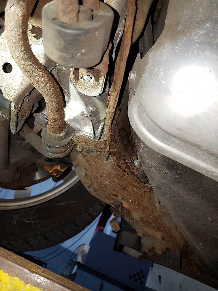

Sainz92 Posted September 18, 2017 Posted September 18, 2017 Hi all I'm not sure whether I'm posting this in the right place but basically my car failed the MOT on Friday due to a rusted rear cross member and brace. So I was wondering whether anyone else has experienced this and whether anyone has had any experience changing one of these out? I'm having a bit of trouble sourcing the parts at the moment, but I was hoping to perform the change myself over the next couple of weeks/months. Pictures of the rot is below. Quote
shawnsx Posted September 18, 2017 Posted September 18, 2017 This isn't to big a job to do, zmalex will have some used and potentially new brackets along with torqen and tarmac sportz I think. Quote
Adrian@TORQEN Posted September 18, 2017 Posted September 18, 2017 Both brackets in stock, as well as the W brace which I suppose it's also rotten. See here, first 4 products. https://www.torqen.uk/137-braces Quote
Sainz92 Posted September 18, 2017 Author Posted September 18, 2017 Thanks guys! You absolute legends! Quote
Adrian@TORQEN Posted September 18, 2017 Posted September 18, 2017 Most welcome. The brackets come with brand new hardware, the W brackets doesn't come with hardware, but you can buy it separate, all products are listed in link above. Shout if you need any more info Quote

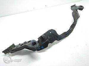

Sainz92 Posted September 28, 2017 Author Posted September 28, 2017 On 18/09/2017 at 18:35, Adrian@TORQEN said: Most welcome. The brackets come with brand new hardware, the W brackets doesn't come with hardware, but you can buy it separate, all products are listed in link above. Shout if you need any more info Thanks mate! Should be ordering next week when I get paid. Do you have the rear floor partition (I think that's what it's called). the part that connects the 2 stays, I'll put a pic below. If not do you reckon its structural/needed? Thanks Quote
Sainz92 Posted September 28, 2017 Author Posted September 28, 2017 Sorry forgot the pic haha, it's the connecting part that I'm after too. Quote
Adrian@TORQEN Posted September 29, 2017 Posted September 29, 2017 They are £228.60 but not in stock, it will be 1-2 weeks to get it here. I've asked my colleagues to list it on the website in case you decide to order it. Quote
Adrian@TORQEN Posted September 30, 2017 Posted September 30, 2017 Listed here now: https://www.torqen.uk/nissan/350z/body-styling/interior/12520-350z-board-assy-rear-floor-74510-al500.html Quote
Tom_K Posted November 21, 2017 Posted November 21, 2017 Not to step in and put someone off a purchase but I will say that that the connecting part mentioned above is a big job to replace! Plus, in my humble opinion (and I'm sure the 'nissan engineers know best!' argument will come up) I don't think it does all that much, having studied where it mounts etc. If anything, it looked like an assembly aid to hang various other bits off in the factory. When I say 'hang' I literally do mean hang; when un-done, it's suspended with some small plastic straps. Quote
Sainz92 Posted May 15, 2018 Author Posted May 15, 2018 On 21/11/2017 at 18:11, Tom_K said: Not to step in and put someone off a purchase but I will say that that the connecting part mentioned above is a big job to replace! Plus, in my humble opinion (and I'm sure the 'nissan engineers know best!' argument will come up) I don't think it does all that much, having studied where it mounts etc. If anything, it looked like an assembly aid to hang various other bits off in the factory. When I say 'hang' I literally do mean hang; when un-done, it's suspended with some small plastic straps. Spot on mate, I ended up cutting it out and not replacing it, there is no way that it could be structural as its very thing metal and as you said, suspended by plastic straps. I didn't realise that I would have had to drop the rear sub frame to fit it. It's only connected to the 2 sub frame stays. Quote
Sainz92 Posted May 15, 2018 Author Posted May 15, 2018 Apologies for the lack of updates.After many cold evenings and a bit of blood, sweat and a busted thumb (5lb lump hammer vs thumb) I managed to sort the rust issue and got the car through the MOT and back on the road in December. Luckily all of the rusted components were bolt on parts which were pretty easy to replace (apart from one rounded nut which caused havoc and had to be split, but was in the worst possible place with literally no access). before afterWhen the car was on stands I took the time to Kurust any signs of developing rust and then undersealed the under body of the car the prevent another ball ache. The parts were bought from Torquen, who were excellent and provided a fast and easy service! 1 Quote
