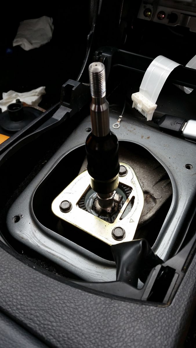

Cookie Posted June 22, 2015 Posted June 22, 2015 Does it feel like there's a notch in between 5th and 6th? I had this issue when I first bought my Zed and re-aligning the gearshift plate sorted it for me. This bit: There's a post somewhere on how to do it. Maybe worth a try as its easy to do if you have a socket set. 1 Quote
