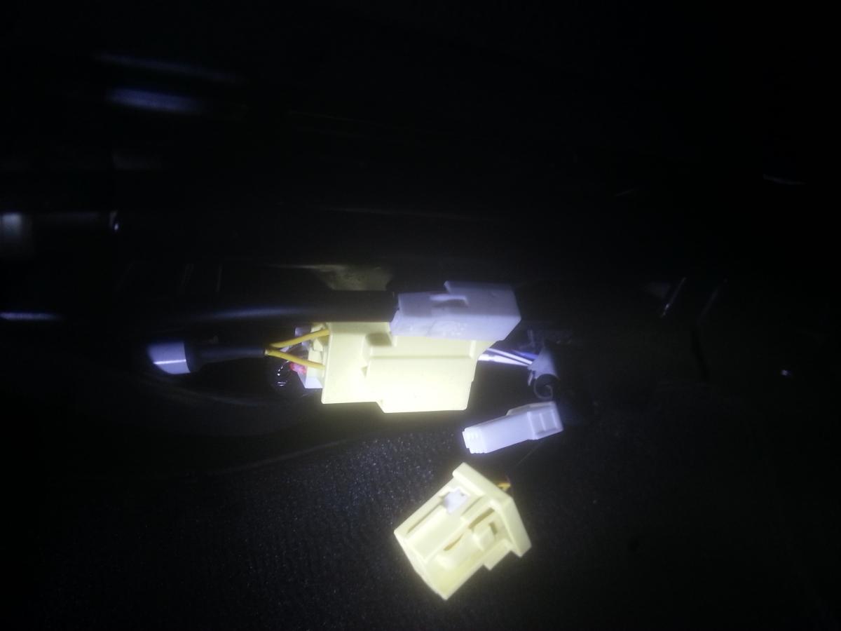

The airbag light on my car has come on recently and having done the reset several time it continues to come back on flashing.
I have disconnected and reconnected all the cables\plugs under the seat to no avail.
On disconnecting and reconnecting all of the plugs under the seat I noticed that the cable (I believe for the seat belt plug) has no connection into the cars wiring loom on the passenger side but does on the drivers side. This doesn't seem right to me so thought it was worth asking as the next step for me is to drop the car into Nissan.
Photos of the offending plugs attached white plugs is the one that has not connection into the cars wiring loom.

Secondly, I don't believe that the white plug is anything to do with the airbag, I think it's for the seat heaters.

:welcome: to the forum. The yellow plugs are the SRS wires and only play with these when the battery is disconnected! Pull both seat plugs then reconnect and put the battery on, then try resetting, if they wont reset then have the codes read properly so you know where the fault is so that you can investigate further. You may have a snapped wire, dislodged pin or even worse a faulty clock spring unit.
I am sure it's an easy fix related to the seats though :thumbs:

I don't believe the white plug is connected to the heated seat on mine as the heated seat still works on the passenger side.
I might have another go at disconnecting them all and checking the plugs and connections within again, failing that it looks like a trip to Nissan to read the fault code at least that will give me a clue as to the cause.
