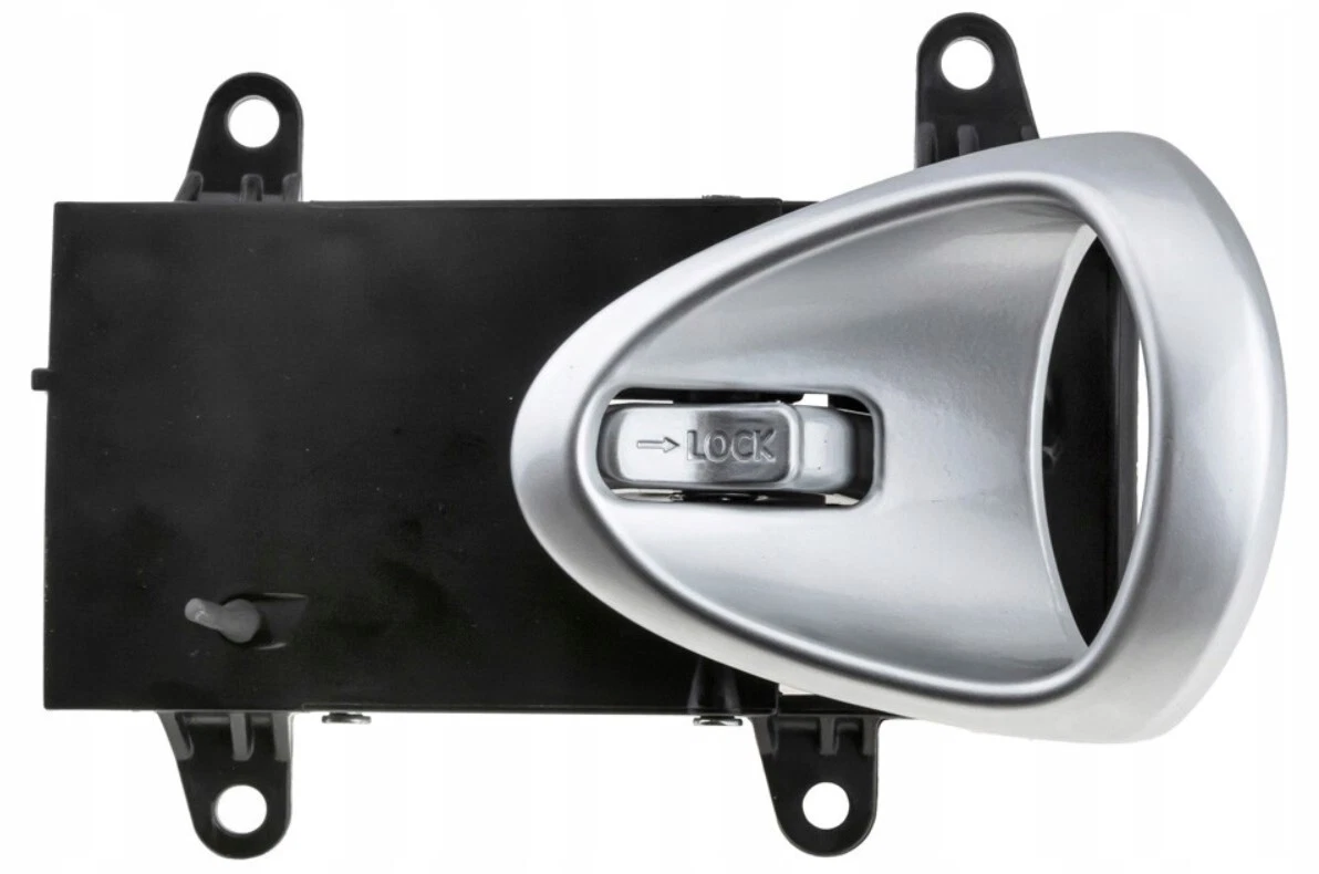

If its mechanical and should work im guessing the barrel has failed? Do you know how the little silver switch in the picture below works? ive managed to push them into the unlock position on both sides but still cant get in? I can also see the boot release tab so im going to see if i can hook that tomorrow and climb on through the boot to open the bonnet but if that fails i will try your method and hopefully gain entry to the bonnet that way. Thank You Nissan 350Z Front Left Inner Door Handle - Picture 1 of 5
You will not get access to the cabin from the boot area I am afraid.
Operating the cable from under the arch liner is the way to go unless you are good with a slim jim lock out kit.
The lock buttons on the interior handles are electrical.

I do have a kit to get into the car ive used the little air bag to pull the glass away from the body and pressed all buttons including pulling the handles on the inside but nothing. I can see the boot release tab so i will try that. sorry i should of explained i have a kit to gain entry but everything ive done so far hasnt worked.
