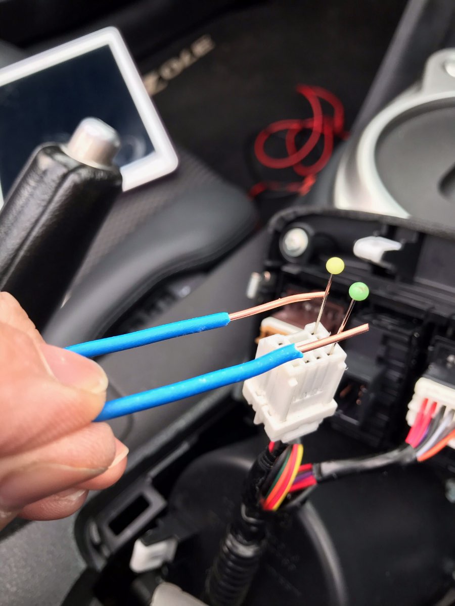

You will need two sewing pins and a small length of wire bent double with the two ends exposed.

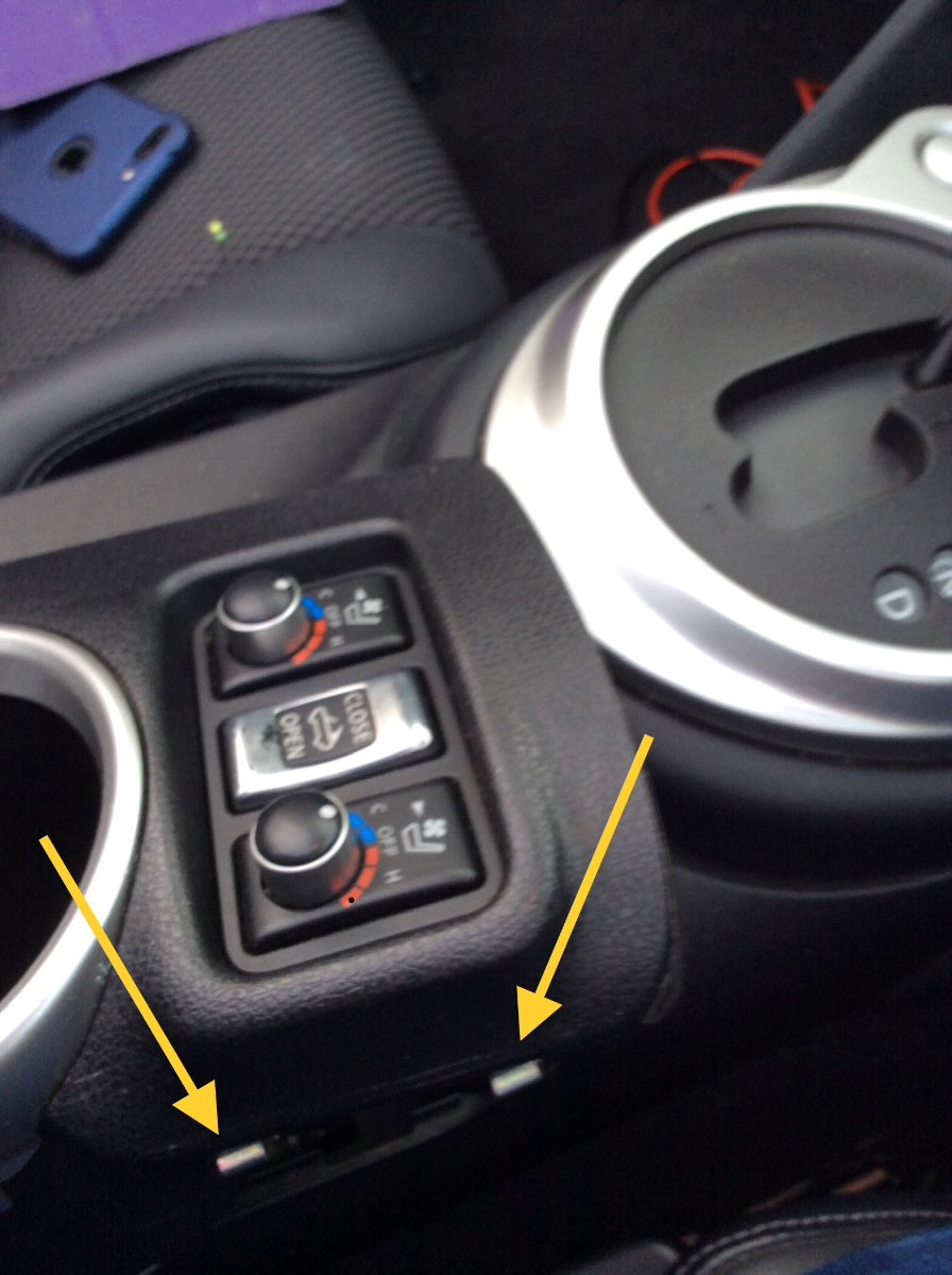

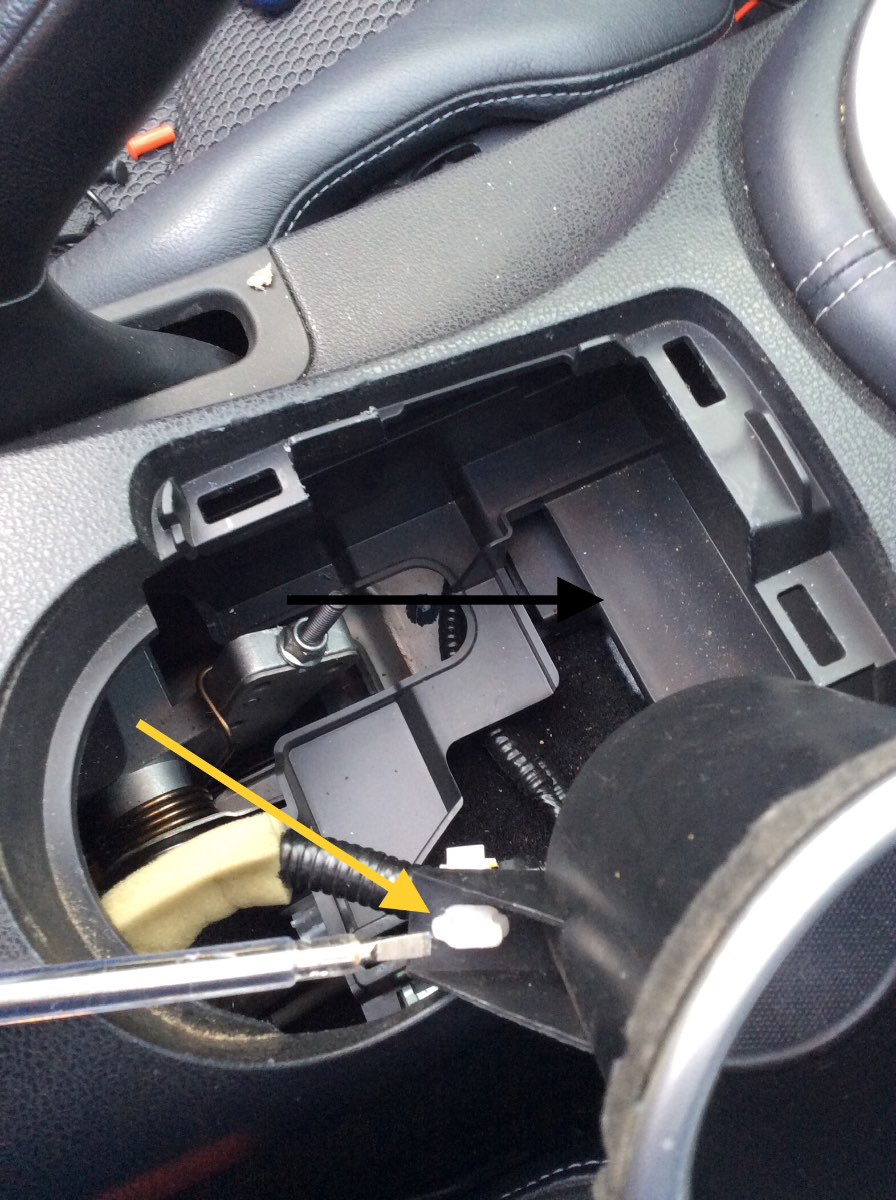

pull up the plastic housing via the cup pic 1. This is only held in by a few clips no need foe any screwdrivers or prying tools pic 2. Unclip the wiring from the cup pic 3/4 this helps manoeuvre the unit better. Unplug the connector by depressing the small tab and pulling it out of the switch itself pic 5. Insert the pins into the two slots pic 6 and touch both pins with the wire as in pic 7 this opens the hood. To close the hood put the pins in the slots in pic 8 and again connect together with the wire.
