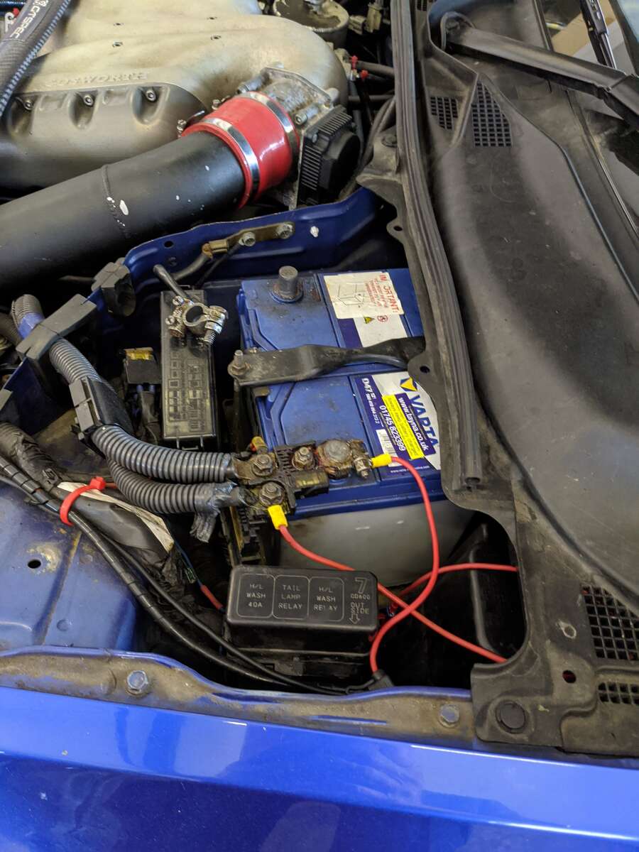

KCook Posted June 12, 2020 Author Posted June 12, 2020 20 hours ago, ZMANALEX said: The front windscreen pump is in the O/S reservoir. The rear windscreen pump is in the O/S reservoir The headlamp washer pump is in the N/S reservoir. First thing to do is check your fuses etc and then you will have to get your multi meter out and check for feed to the pumps. there are 3 fuse boxes: 1 is inside the O/S/F footwell. 1 is beside the battery 1 is within the IPDM unit under the scuttle on the N/S/F behind the battery. Easier to check the feeds to the pumps with the bumper off. Hi Any idea in which of the 3 fuse boxes the fuses for the washer pumps are located? Quote
