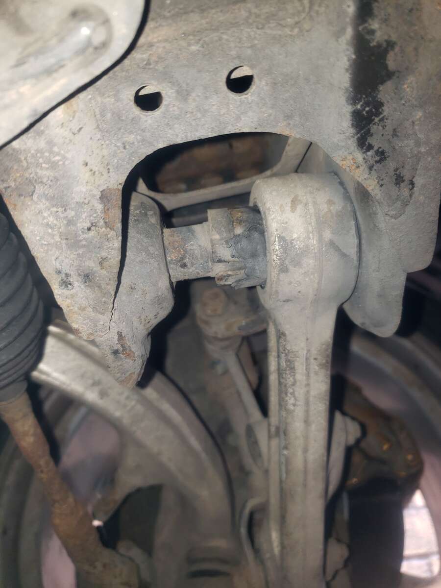

Hi guys.
Probably know the answer to this but thought I'd check.
Getting a knock fom under the car, seems to be more when cornering.
Found the inner control arm bushes to be looking a bit of a state. Would you all agree?
And just out if interest,  I'm assuming that arm should sit centrally not off to one side as it is?
Any upgrade worth looking at? White line etc?
Never seen one as far gone as that mate. :scare:

Well I was hoping to find an obvious fault for the knocking so I'm glad it was that obvious.
Just wondering if there are any upgrades worth considering?
Does the whole arm need to come off?
Worth doing the other bush and outer bearing?
