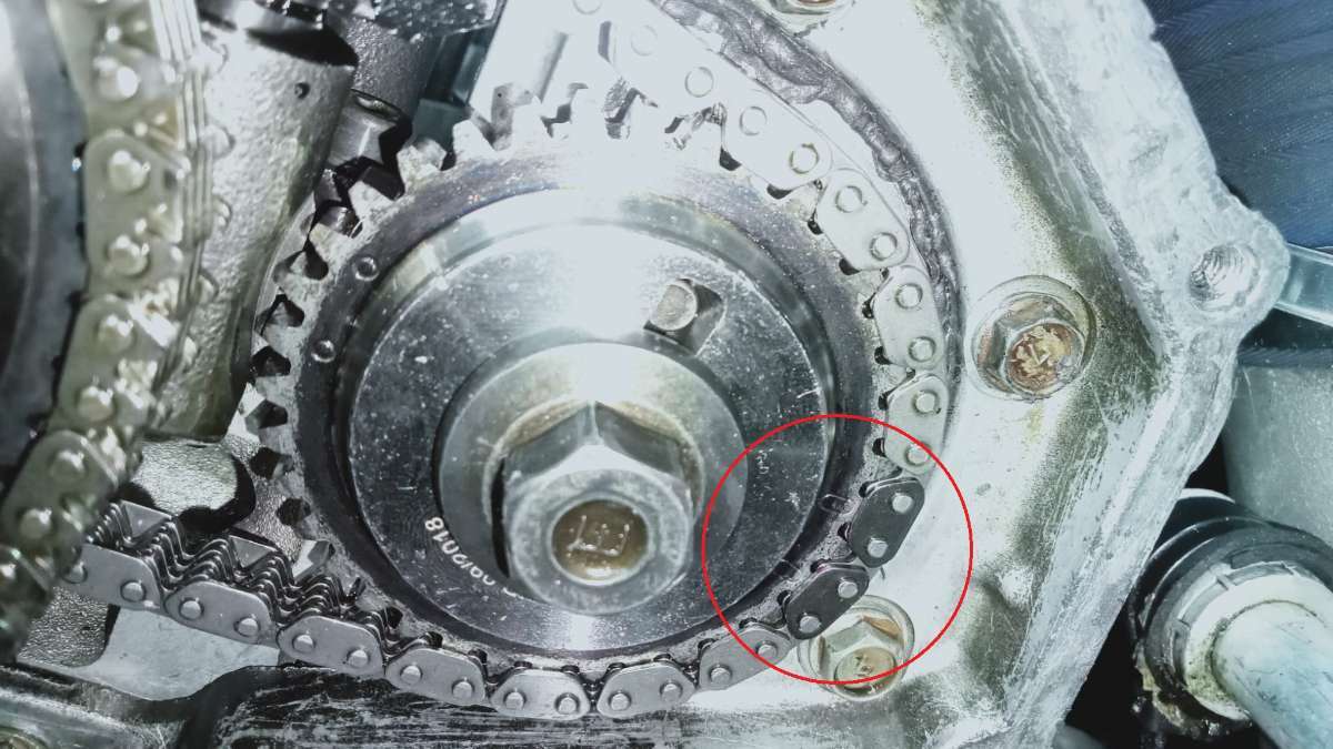

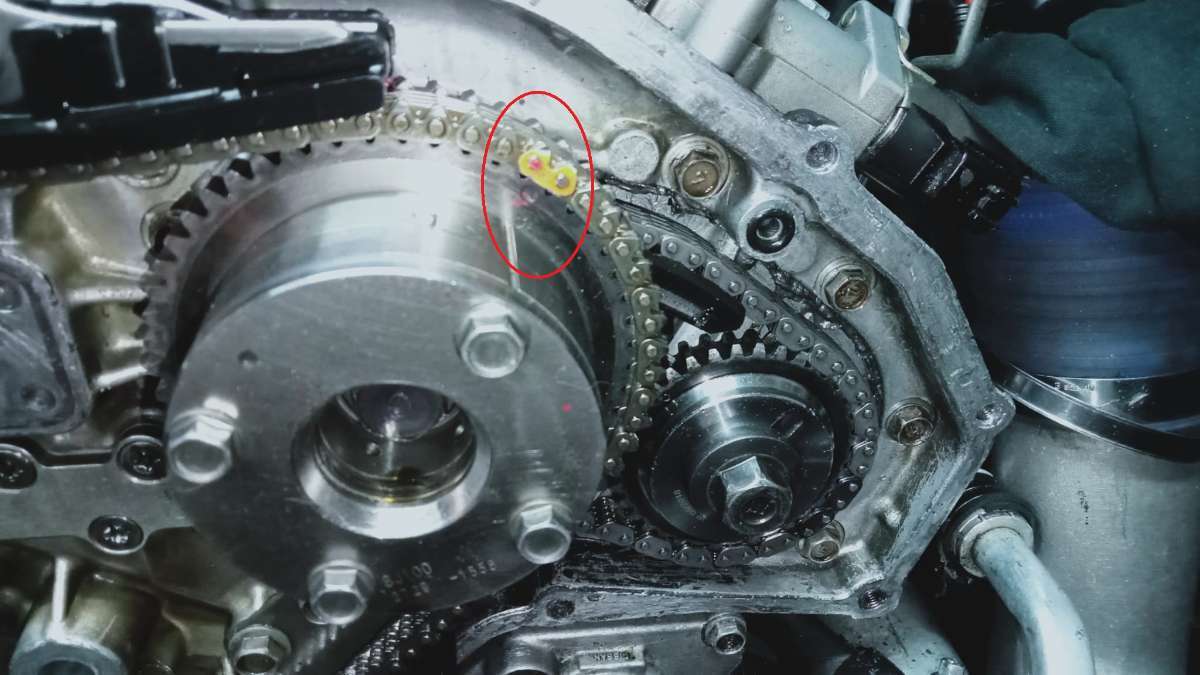

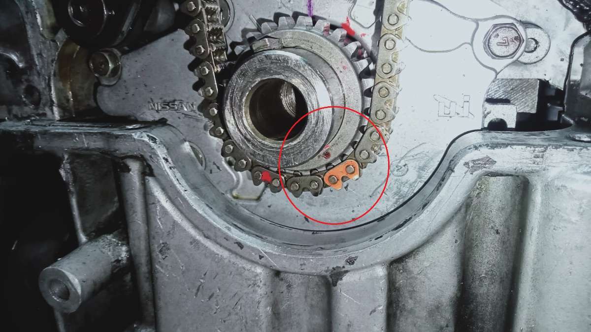

after rebuilding my engine (again) and installing the timing chains, i realize that the timing mark on the crank pulley and the mark on the exterior cover do not match.
I stopped the build cause i never realize it and now im a contused
Analyze the pictures and give some pointers here

Hi, IMO i would say the timing may be correct. The chain and sprocket marks are highly toleranced so they are primary interfaces for the timing. The cover relies on clearance holes to fit the bearings and is visual only.
I found this Youtube clip and the guy has put his Z at TTC, however it also shows the cover & pulley marks in the same position as yours.
