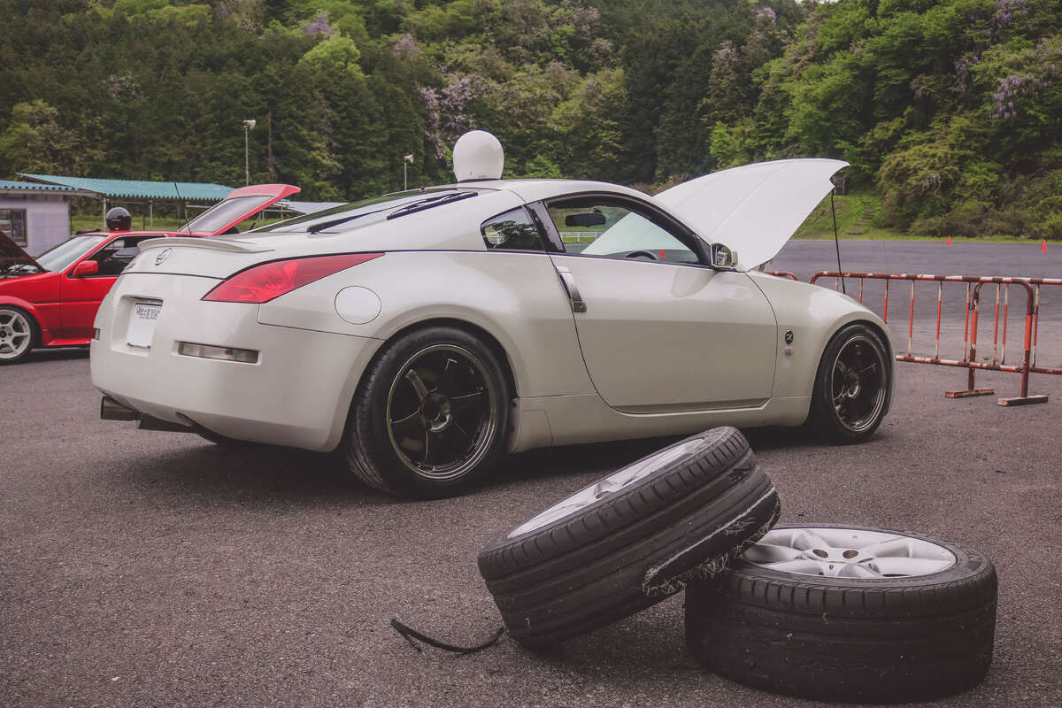

A piccy from the event because everyone loves pictures.
