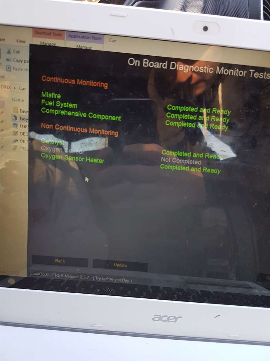

lct Posted December 16, 2017 Author Posted December 16, 2017 Cheers alex. I plugged the car into my mate's laptop today and only the p0174 code has returned, not the other one. Will this help narrow it down or does it just open up more possibilities ha. Also when running the diagnostics the o2 sensor checks weren't completing? I've attached an image. Is this normal or could it be related to the fault code? Quote
