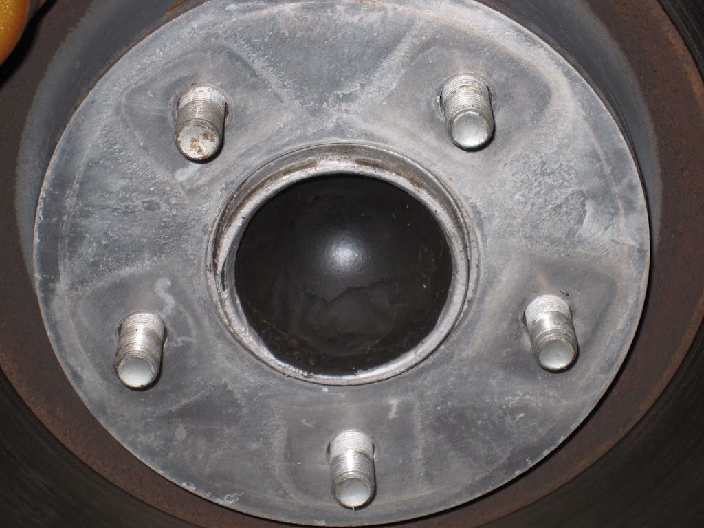

The TVR has the same 5x114.3 PCD as the Zed but with a 70.1mm bore and 12.7mm diameter studs compared to our 66.1mm bore and 12mm studs. Seemed like they might be close enough for Zed purposes so I bought a pair to try out:
They fitted very well, almost exactly the same outer diameter as the front hub mounting face. There's a little bit of movement as you would expect but once the wheel nuts were done up finger tight it was very easy to centre on the front hub. I didn't try them on the rear, should be much the same but you'd be judging it by eye centring on the wheel face as the rear hub face is much bigger.
