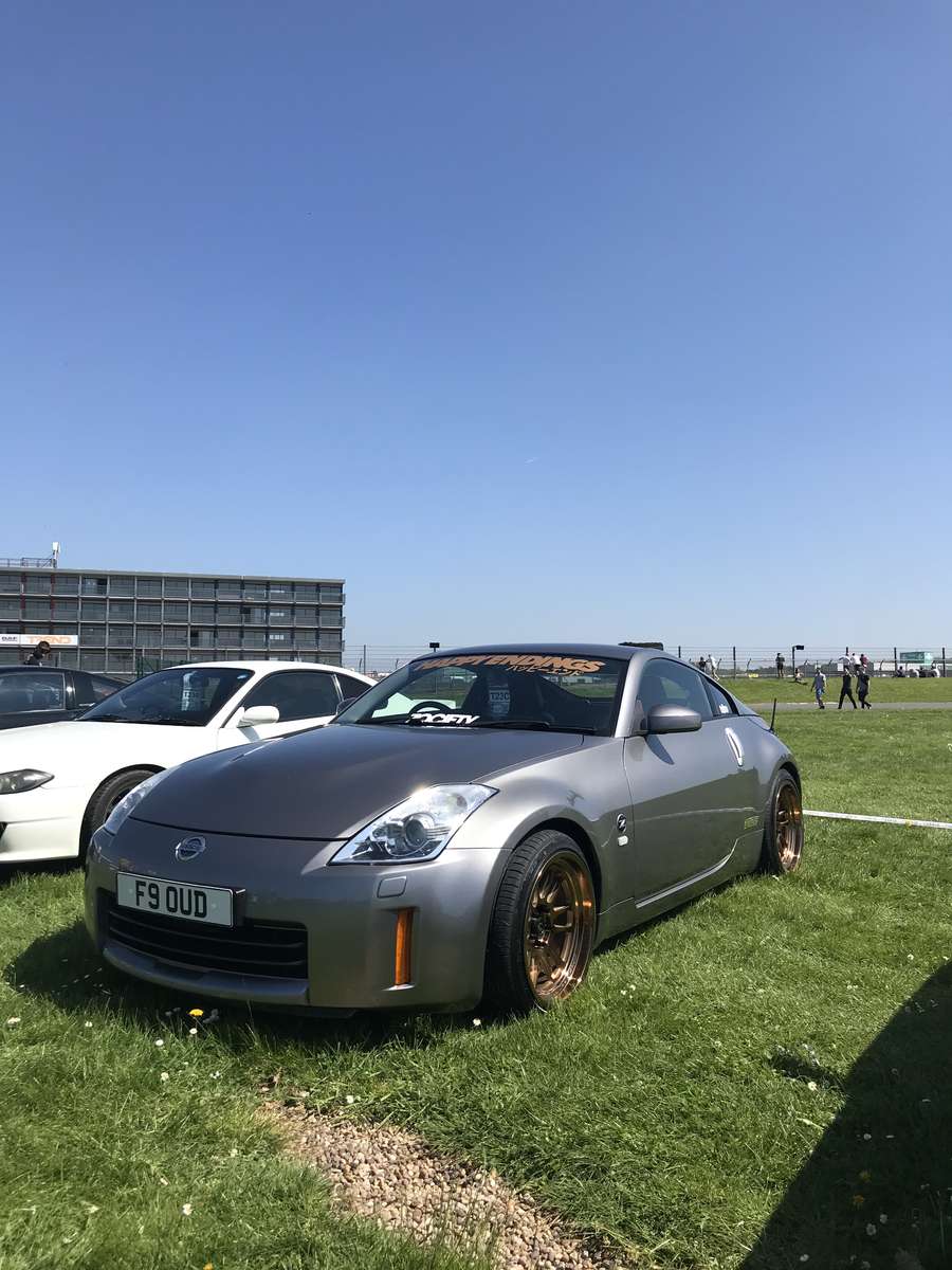

However, after talking to Mike at Walton Motorsport I decided on some Cosmos XT206R wheels and accompanying Tein Flex Z suspension on his personal recommendation. I picked the wheels up in an 18x9.5 sizing and ordered some Superforma 22mm spacers for the front wheels to fit around the large Brembo calipers up front. This meant I was running +10 offset in the back and a fairly aggressive -12 offset in the front. After a heavy impact with a curb I had the car at the garage to get a new wishbone arm and the coilovers fitted. After a quick trip to get the wheel alignment done I was ready for Japfest this past weekend and beginning my adventure with this car after sits first couple of mods.
