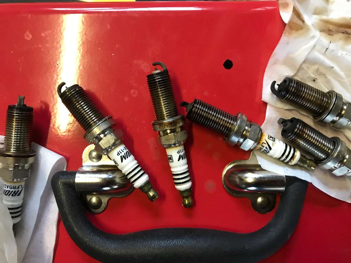

Update:
Today i replaced 3 ignition coils, all spark plugs and RTV'd the leaky oil seal (plug #6 from the top). Upon checking the right-side valve cover a little more thoroughly i noticed the spark plug seal was coated lightly in oil - so both covers need to be replaced in the near future.
I took the car for a 15km drive and it seems as though it's been cured; the idle is smoother, response is better and it seems to hold fine at cruising speeds. I'll need to go on a longer drive next weekend to really evaluate it - corona virus permitting. I'm reluctant to believe this could be cured from just plugs and coils, but please take a look at the plugs below to see what you think - they're not in the best shape for sure.
I also ordered a MAF the other day thinking it might be this; so if anyone needs a MAF in the Aichi prefecture area HMU.
I'll report back later to notify everyone of my findings.
