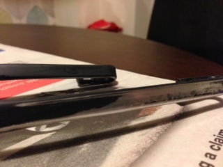

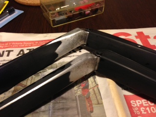

After much looking around for new wiper arms "couldn't be bothered painting them" with no luck i decided to paint them so off i went to get some supplies and needless to say the mini project has started, didn't take any before pics on the car however here are some with the corroded areas worked down to the metal, i only had a little bit of paint bubbling but when i took them off it was a little more widespread that i thought but hey ho not worth doing twice so lets do it right first time...

Once off i suggest you use a screwdriver or something similar to remove all the very lose bits, i then used some 80-grit paper to really work down the damages areas. My best advise it give them a good going over when i could initially see was small but actually had a lot of bubbling all over. I also used a small power tool with a wire brish head to help remove some of the "pitting". Once the crud is removed i used 400 grit paper and then 1200 paper to smooth the whole arm. Once happy i give them a good soapy wash.

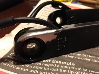

Once they are fully dry from the wash i started with the primer, first i applied 2 coats about 15mins apart then after about 20mins i gave the whole arm a gentle rub down with 1200 grit paper. I then applied another 2 coats again 15mins apart before giving them another rub down, below is the end result after the primer. Remember to keep the can about 9in away from the wiper arm and move at a consistent speed "common sense i guess"

I applied 4 coats about 15mins apart before giving the arms a gentle rub down with 1200 git paper, I then proceeded to add about another 4-5 coats to be honest think i may have added too many but i got carried away... I left them a good 40mins to dry before adding back on the zed

The end result:
This was my first attempt at doing this and considering that fact i was very happy with end result. I would suggest anyone to give it a go !!!! SO pleased with the end result i have been looking for other things to paint :) Thinking of doing center console next :)
