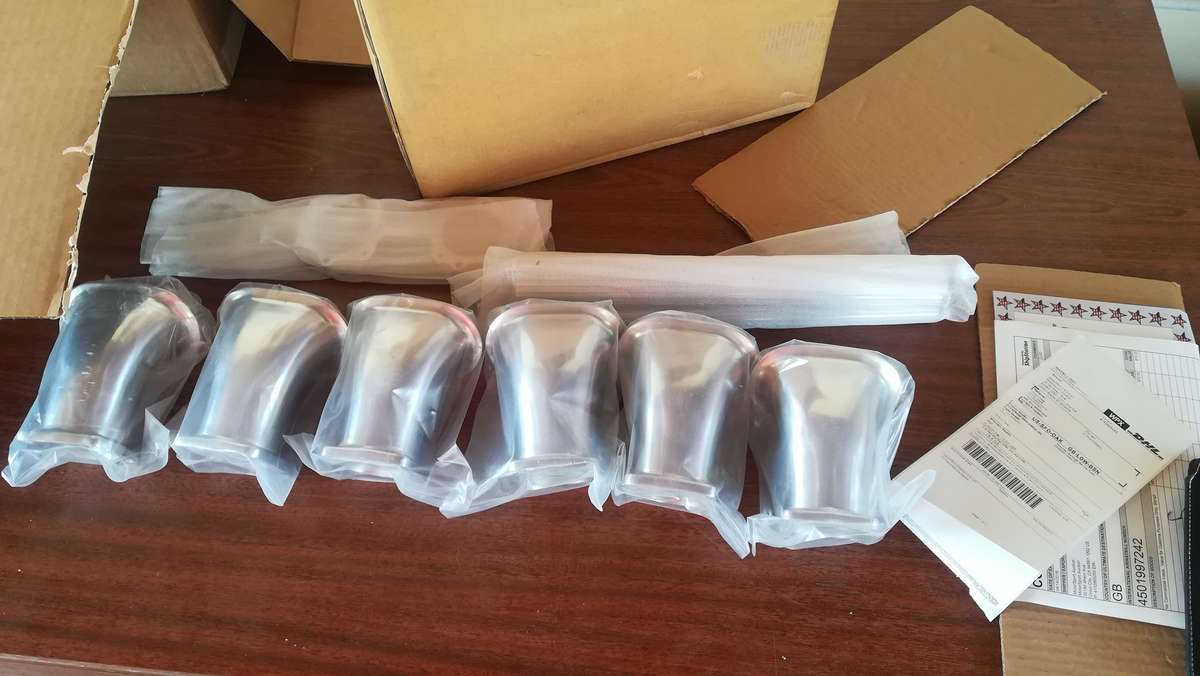

For many reasons already discussed in my  DIY individual throttle body thread the project has been abandoned and as per the title I'm installing OBX individual Throttle bodies which arrived wednesday 3 days from america not bad
These have had a lot of bad press but strangley I've not come across anyone who has actually fitted them it's all hearsay. Jenvey are understandably upset as they appear to be a direct copy of their setup so I can see their point
after unpacking them and having a good look some of the criticism is definatley fair the quality of the castings and  machining of them is not up to jenvey standards and there are no instructions whatsoever not that I would have read them I'm a man god damn it.
The throttle bodies look good and the parts supplied quite comprehensive if I paid jenvey money for them they would go back but I didn't I paid a third of that

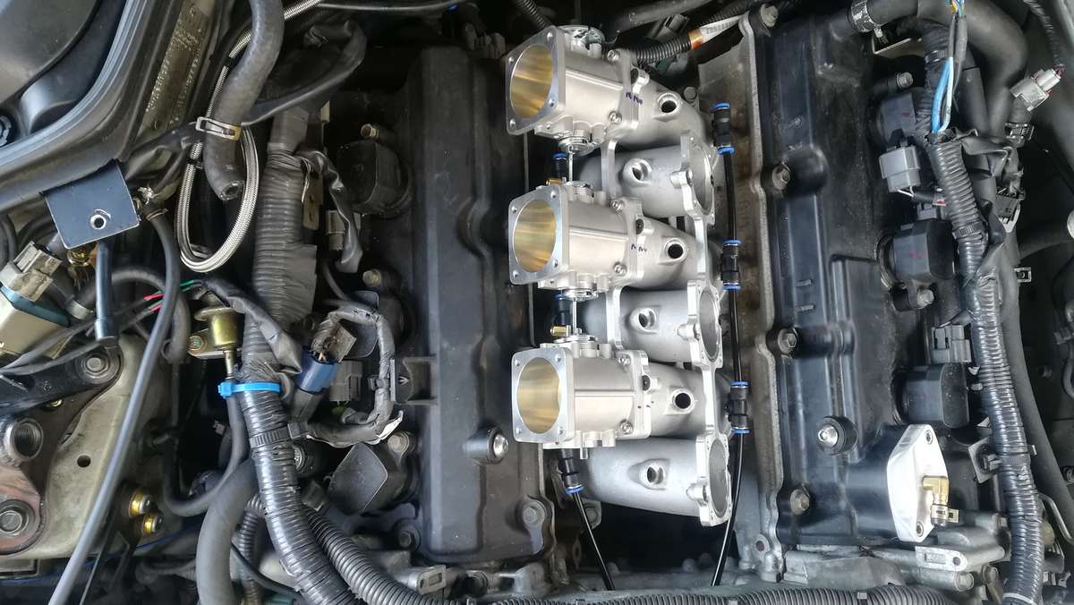

So now I can see what it fits like
good so far that is untill you fit a throttle body and velocity stack anyway
there is no picture of this yet as not a single one fitted. with a standard 350Z rocker cover the filler would be in the way luckily I've already changed mine as I already had this problem with first ITB setup I had
this one is from an Elgrande I believe, despite that I still had to modify the cap I made, cut off and blank the front breather pipes and all of the brackets the injector loom fixes to
and clearance is still tight
the other thing I've had to do is reroute some cables, nothing too drastic (yet)
I've also drilled and tapped the manifolds for the vaccume takeoff neither the OBX or jenvey come with this pre-drilled an tapped

A lot of my day has been spent doing things obx should have done properly tapping holes through that were only partially done countersinking some holes properly etc mostly minor stuff but it still had to be done and still took time also you can't bolt it all together on the bench and then fit it, everything has to be built on the engine due to clearancesbeing so thight.
so here is my days progress
still plenty to do my aim is to get it started next weekend, maybe possibly
So the next problem (I'm sure it won't be the last) is the fuel rails' I dropped some injectors in tonight and thought to myself that looks a little tight
it doesn't matter which way around you put the injectors or the supplied fuel rails they either sit on top of the injector connector for the other bank or just push the injector over at an angle unless the injectors were about an inch longer these fuel rails would never fit
luckily I have a spare set of standard fuel rails that I've started modifying to fit
even though I expected a certain amount of problems that doesn't mean it's acceptable and I have got onto the supplier about the various issues especially as they suggest that this is virtually a bolt on kit :lol:

yes it started first turn of the key about an hour ago
then the heavens opened up so I'm sitting here in my pants looking like a drowned rat but smiling like this :teeth:
The suppliers /manufacturers were useless with the issues apparently I don't know what I'm talking about :dry:
I machined a pulley to go onto the throttle servo so it's all cable operated for now anyway also had to blank another one of the breathers on the rocker cover
I cut and welded the standard steel fuel rails to fit and strangely they came out similar to the Jenvey ones so Jenvey don't know what they're talking about either :lol:
and completely re-did the fuel system and vacuum setup much neater
