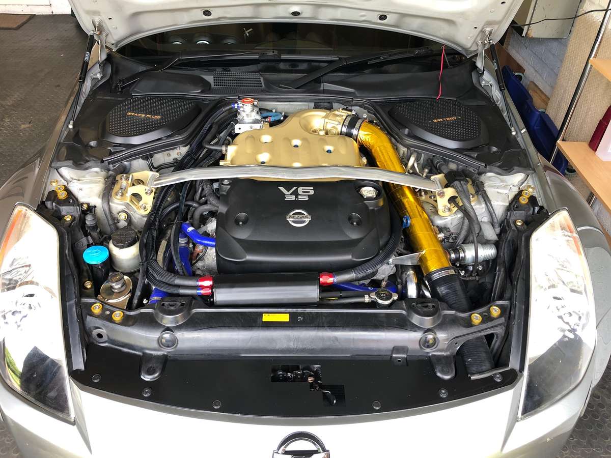

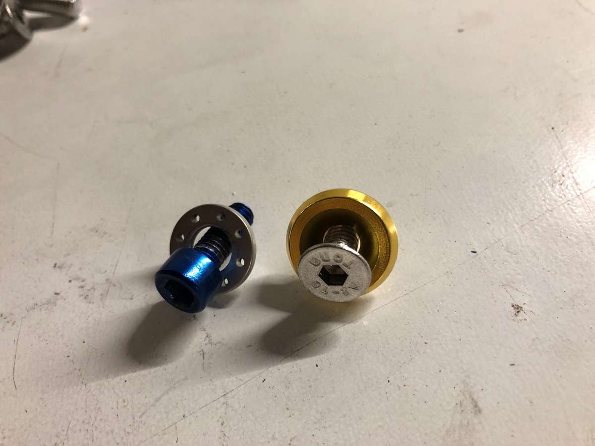

Month 7: June 2018
Completed This Month:
  • Replaced blue engine bay dress up bolts with gold
  • Finished heat reflective tape on intake pipe
  • Clear fog light LED conversion
= £50 total
So not a massively exciting month on the modification front at least, but some well overdue tidy-up jobs have been completed. First, replacing the rather badly mismatched engine bay dress-up bolts and washer (Well, currently all bar the plenum bolts anyway) to at least have a bit of consistency with the colour theme throughout the car. The blue samco hoses still upset my OCD somewhat, but I'll hopefully get around to them at some point soon.

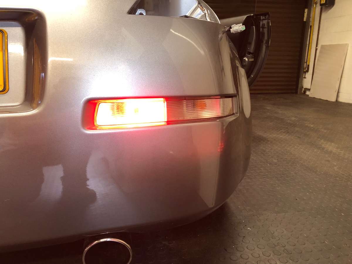

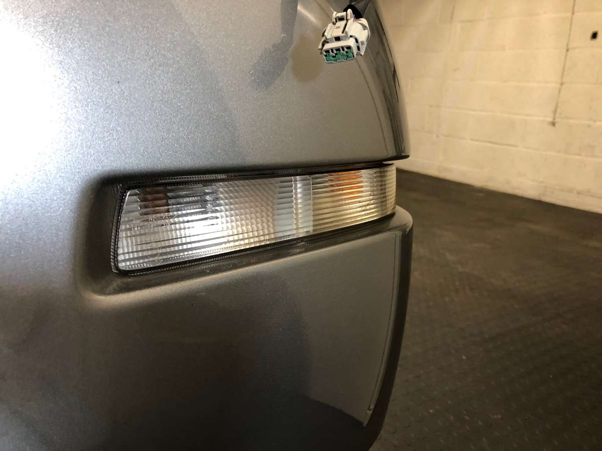

Finally, another OCD-satisfying job was to remove the red lens from within the rear bumper light cluster, and then install a high-quality red LED bulb. I managed to locate an Osram LED bulb that does the job very well indeed. :)

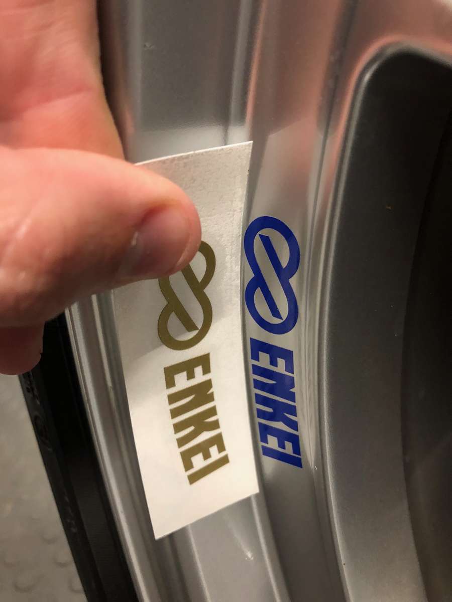

Next month - well this is the next big month really! The Enkei RPF1's go in for a refurb, and will be coming out gloss black. I've also had some bespoke Enkei rim logos created, again in a colour that goes with the theme, and these will get added once the wheels are back on the car. I'll also be installing the black Muteki nuts and locking wheel nuts that were purchased last month.
hello mate, dont suppose there is a part number for these bulbs? cheers
Edited by Konflict89
Share this post
Link to post
Description from my order:
Osram 7705R 02B LEDW21 W 12 V Standard Retrofit T20 SC Red Twin Blister
Share this post
Link to post

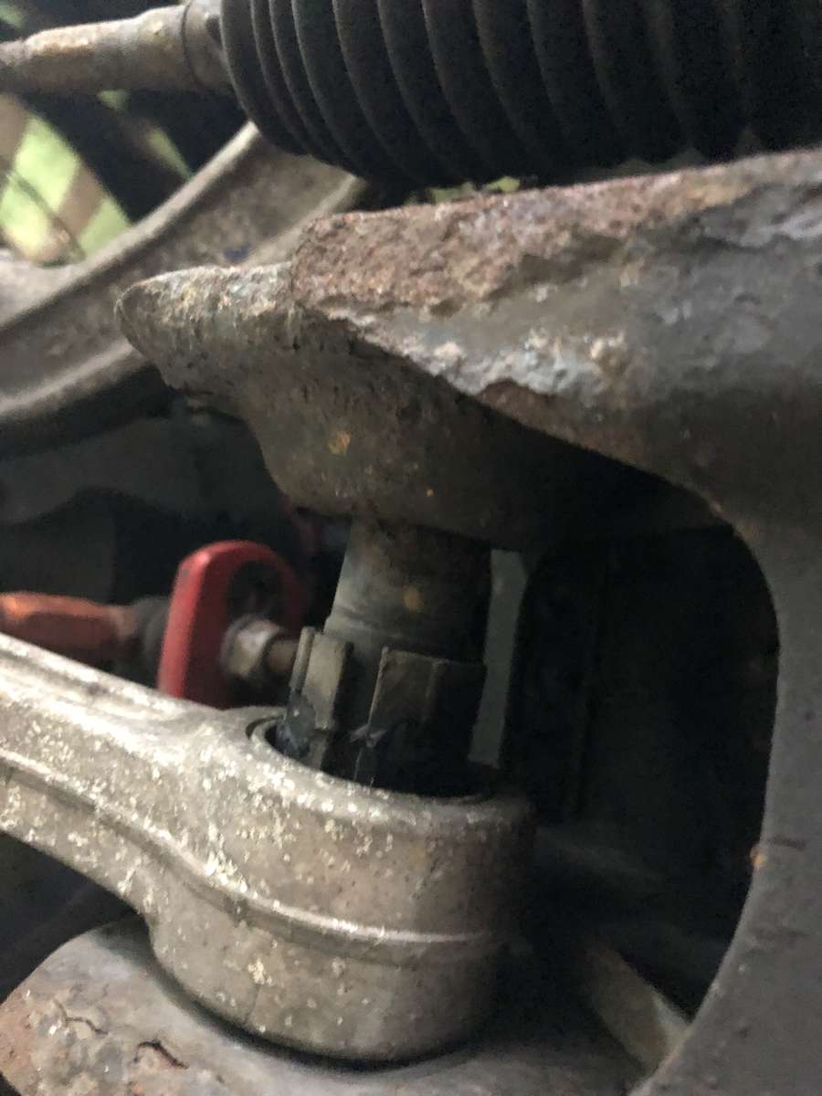

During the service, it was noted that one of my front lower suspension arm bushes was knackered. (See photo). Unexpected given the low mileage since last service and MOT, I gave them the nod to replace it; after all it was an MOT failure otherwise. As with all things suspension, it was best to replace both bushes (1 at either end of the arm) and of course, the same on the other side of the car. An expense I hadn't anticipated, but well worth doing.
Along with this, it was recommended to get the alignment done, to which I agreed. Whilst performing alignment, it was noted that 1 of the rear wheels was a long way out of alignment, but given the odd configuration of my car it couldn't be brought into spec. Having adjustable camber and caster arms was fine, but the toe was where the issue lied. It looks like the previous owner decided to put lockout bolts in the standard toe arms - and thus negating any possibility of adjustment. A couple of eccentric bolts later, and the car is aligned and brought back to spec (as much as can be with a lowered zed)

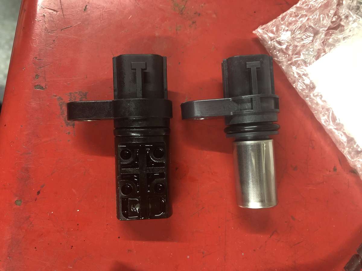

Upon the journey to the MOT, the zed threw another EML, and along with this made it very difficult to start the car during and after the MOT. Error logged - P03040 - Camshaft position sensor A - bank 1.
Errors cleared, and everything back to normal! Multiple test drives prior to taking my return journey home, and no new occurrence.
Wallet significantly lighter, I gave the car a wash and went out for a bit of a spin. 1 mile from home, and my dash lights up like a Christmas tree so I limp home and get it in the garage. After stopping the engine I was then unable to start it again - P0340 logged again.
Off to Clark Motorsport online I go, ordering a new camshaft position sensor. A day later it turns up, looking nothing like I expected.
For reference to anyone reading - 23731-6J90B - the original sensor (Drivers side RHD) has been superceded by Nissan with 23731-6J90C which looks significantly different; rather than black plastic and mostly flat in shape, the new sensor is metallic and cylindrical.
A relatively easy swap (if you have small hands which I don't) - and the car is back up and running again!

I came across this too, bit of a shock at first but is the updated part.
Share this post
Link to post
Thanks bud - I’ve posted in your thread too so that anyone searching the web can feel warm and fuzzy inside knowing they won’t have an issue :) haha.
Rsther that than the mild panic when it turns up..
Share this post
Link to post
I believe Hitachi sensors look like the new sensor I was supplied - it is possible Nissan have now changed supplier - hopefully the sensors are a bit more reliable :)
Share this post
Link to post
