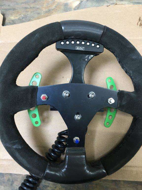

So the first problem we found on the shake down was completely down to me :doh:
I put the shift lights on the steering wheel in the middle and they looked great - until you put a full face helmet on and realise you can't see them :lol:
so upgrade 1 was to move them to the top of the wheel :thumbs:

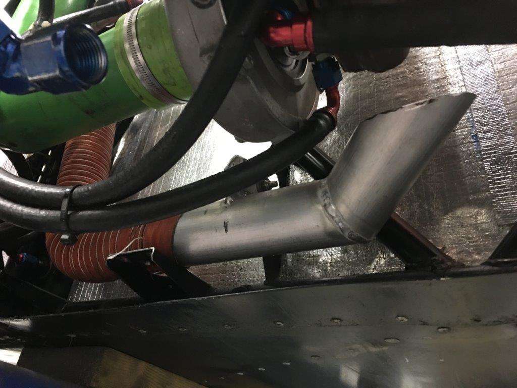

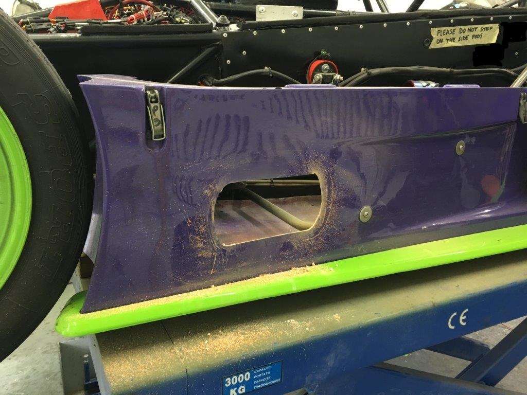

We have an issue with heat and heat soak, the first part of the problem is that the turbo, now the hottest point sits in a dead spot as far as air flow is concerned on a motorbike the turbo would be hanging out the front of the engine in this case the turbo sits directly behind the seats and firewall where there is no airflow at all! The back side of the engine has plenty of air but not the front so after a bit of thinking I bought two sets of these -
Take a side pod
Cut a hole
test fit
paint and fit
Add some ducting
and then point the ducts in the right direction with some ally tube
Add GREEN powder coat
I was almost happy with that except when you put a jubilee clip on the duct IMG_0837.JPG.d207bbefba9ccb2b5e28f9f2c17f08e9.JPG
It collapses :doh:
Bad design really, but like most of us I keep a bar or 2 of poly something or other laying about to make bushes and spacers so I made these
and they go in the end like so
Problem solved :thumbs:

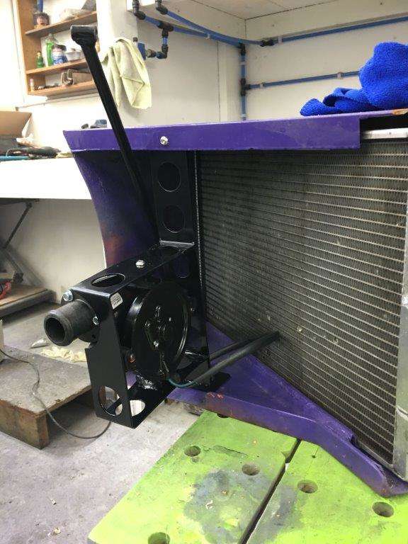

Next on the list for cooling was to upgrade the old Bosch water pump (20 l/m)  to a high performance one
Bosch
Replacement 80 l/m
and side by side
Yer that's not going to be a one for one swap then!
I did some very careful and accurate measurement then a detailed design plan -
:lol:
Still it came out close to that
of course that needs some weight redution
test fit
Getting there , it's also good practice for my ally welding which I have been practising
Top mount and final test fit
All looking good so powder coat and fit up
Then we added an electric  fan to the radiator this will allow us to run the water pump and radiator fan in the pits more so when we come in the heat soak can be reduced, currently she is coming in at around 86 degrees on the cool down lap then going up to 110+ when you switch the engine off or stop moving!
More soon :thumbs:

I took a quick pic of the new air ducts final location to keep air flowing over the turbo
IMG_0940.JPG.a69115b81ff9f8e8bceb23378315de18.JPG-
